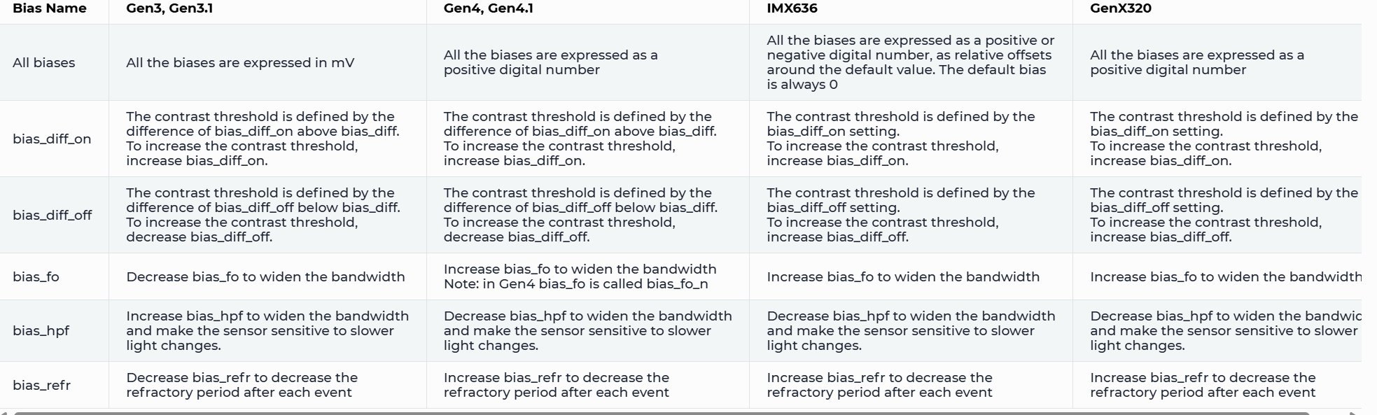

I noticed in the documentation that for the IMX636 model, only bias_diff_on/off has an effect on its sensitivity. But in my tests, I found that bias_diff also had an impact. I want to know what the details should be.
