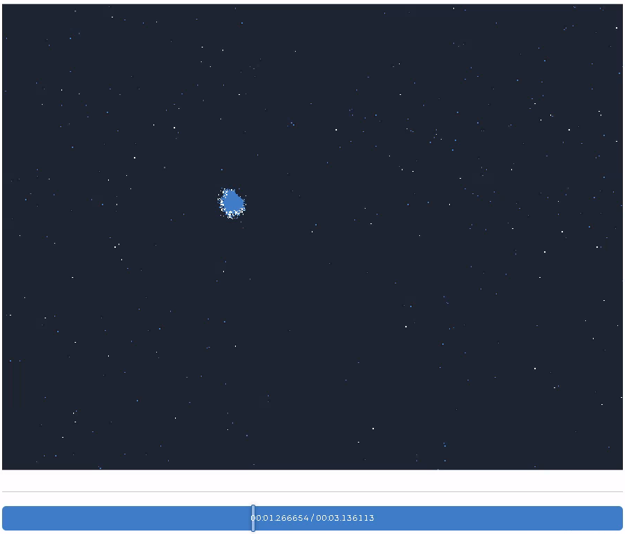

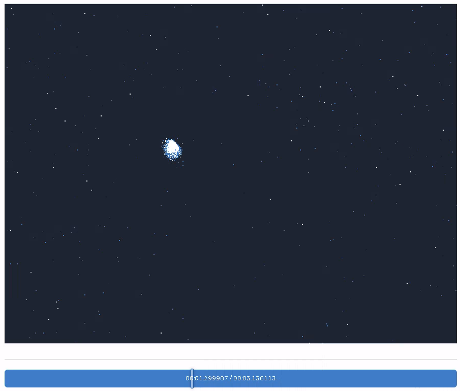

When I view the raw file I'm iterating above in metavision studio, I can see a decent number of positive and negative events in the range between 1s - 2s when the accumulation time is set to 100ms (see screenshots). I would then expect that I would be able to see two fairly populated images when processing them as above since my accumulation time is an order of magnitude larger than the accumulation time set in the metavision studio and I can plenty of events there.
However, this isn't the case. When I investigate the polarities in my events I see a large discrepency:
len(evts[evts['p'] == 0]) # number of negative events: 33
len(evts[evts['p'] == 1]) # number of positive events: 616
What am I misunderstanding about the way the events are displayed in the metavision studio vs the way they are processed using the event iterator? I don't want to use any frame generation algorithms, I need to be able to process the raw events using my own code.
