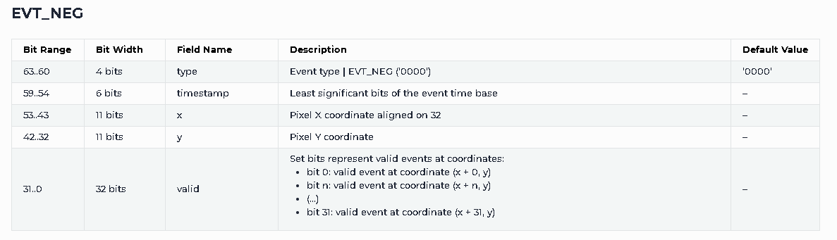

According to the EVT 2.1 format description EVT 2.1 Format — Metavision SDK Docs 5.1.1 documentation
, how should valid bits be understood correctly?
1. X and Y coordinates of the current valid event.
2. After receiving data from the image sensor, we always need to check the valid event through 32 valid bits and calculate the current coordinate of the current event using the formula (x + n, y). What if more than one bit is installed or only 1 bit might be installed per current data packet?
