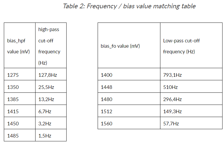

Hi,
I just found this table that relates bias_hpf and bias_fo in terms of high-pass cut-off frequency and Low-pass cut-off frequency but this is for GEN 3.1. Can you please share the table or the graphs (https://support.prophesee.ai/portal/en/kb/articles/bias-tuning-flow) for GEN 4.1 sensor?
Thanks in advance.
