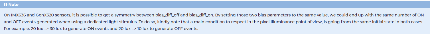

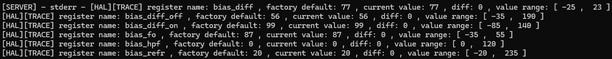

Hi, there is a note that it is possible to get a symmetry between "bias_diff_off" and "bias_diff_on" by setting those two bias parameters to the same value in the biases of metavision SDK docs. I want to know the same value is point to the current value or diff value.
