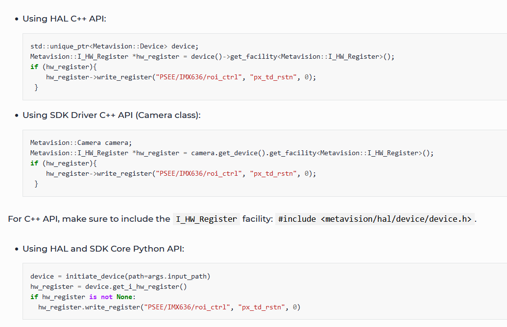

There is an example on the sdk on how to write register values (https://docs.prophesee.ai/stable/faq.html:

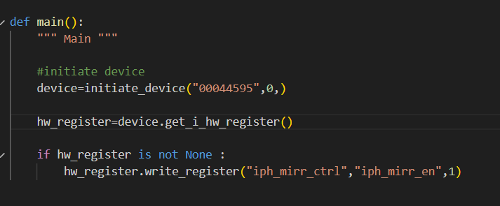

From this, I tried writing in the register with the Python SDK :
This outputs [HAL] [ERROR] Write : Invalid register.
I tried to do the same function on other registers but i get the same output.

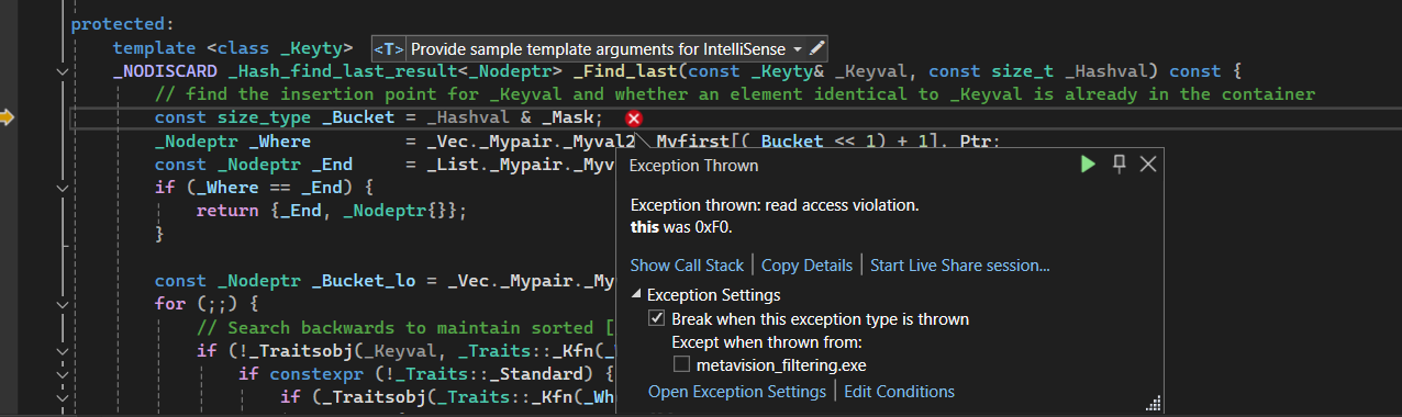

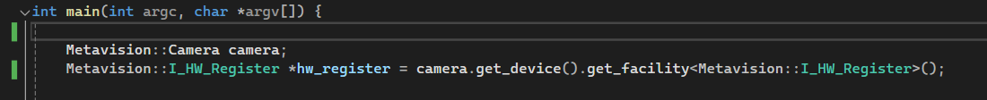

The same test isn't fruitful with the SDK driver C++ API :  I created a hw_register pointer and its memory allocation doesn't seem to work :
I get this message when running the debugger:
This does the same when I use the HALL C++ API.
