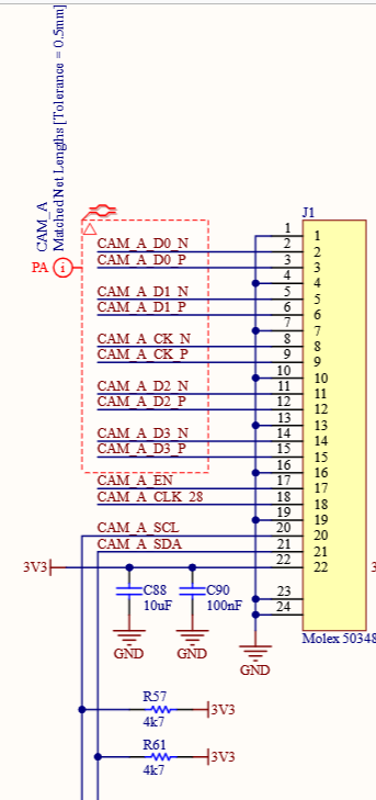

Hi Prophesee team,
My FPGA board has 22pin interface for Rpi compatible camera:
Unlike the KV260 FPGA board, our custom board does not have a pull-up resistor on the RPI_ENABLE (MRSTn) signal.
We are connecting IMX636 with FPGA board via 15pin FFC to 22Pin FFC - cable.
While reviewing the schematic of IMX636 it has some switching mechanism for "PSU_EN" and "MRSTn" signal.
Will my FPGA board's 22pin interface be compatible to IMX636 (15pin header) while using 15pin FFC to 22Pin FFC - cable for RPi_enable (MRSTn) and PSU_EN signals?
Or i have to consider pull-up resistors or power-sequencing considerations?
