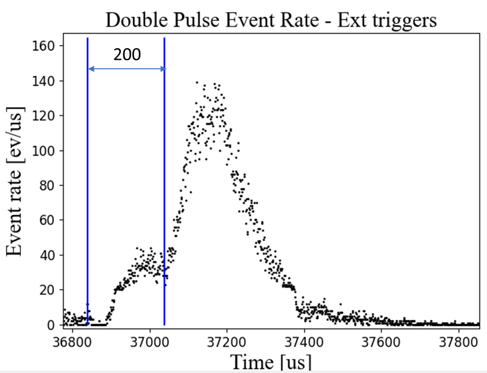

I'm performing some experiments with PIV laser pulses and I see that even though here is specified that the max latency of the sensor is 200 us Temporal precision of Prophesee sensor's readout It seems that I'm having a higher latency.
In the Image the pulses of the laser are in blue. It seems that the events related to the signal of the first pulse are overlapped with the second pulse events and it seems that the camera is taking around 400us to generate all the events related to that pulse that last only 0.5 us.
I would like to know why is this value that high if is supposed to be max 200us? Thank you so much.
