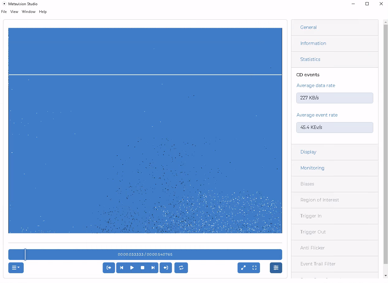

Hello Again,
I apologize if I am spamming this forum, I've gone through the documentation, but I'm still running into some strangeness I cannot explain.
I am trying to record several raw files in quick succession. I'm doing this with the HAL python library and a timer in a separate thread. Each time the timer goes off, we stop streaming and start again. This is resulting in raw files that are mostly normal except for the first few milliseconds which are totally saturated in negative events. Has anyone seen this before?
