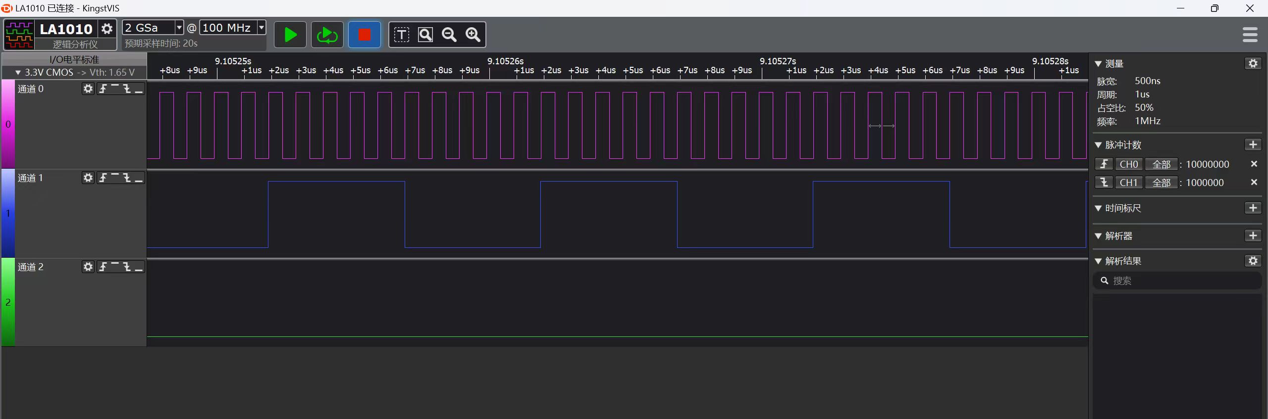

External trigger source 1MZ, logic analyzer test results

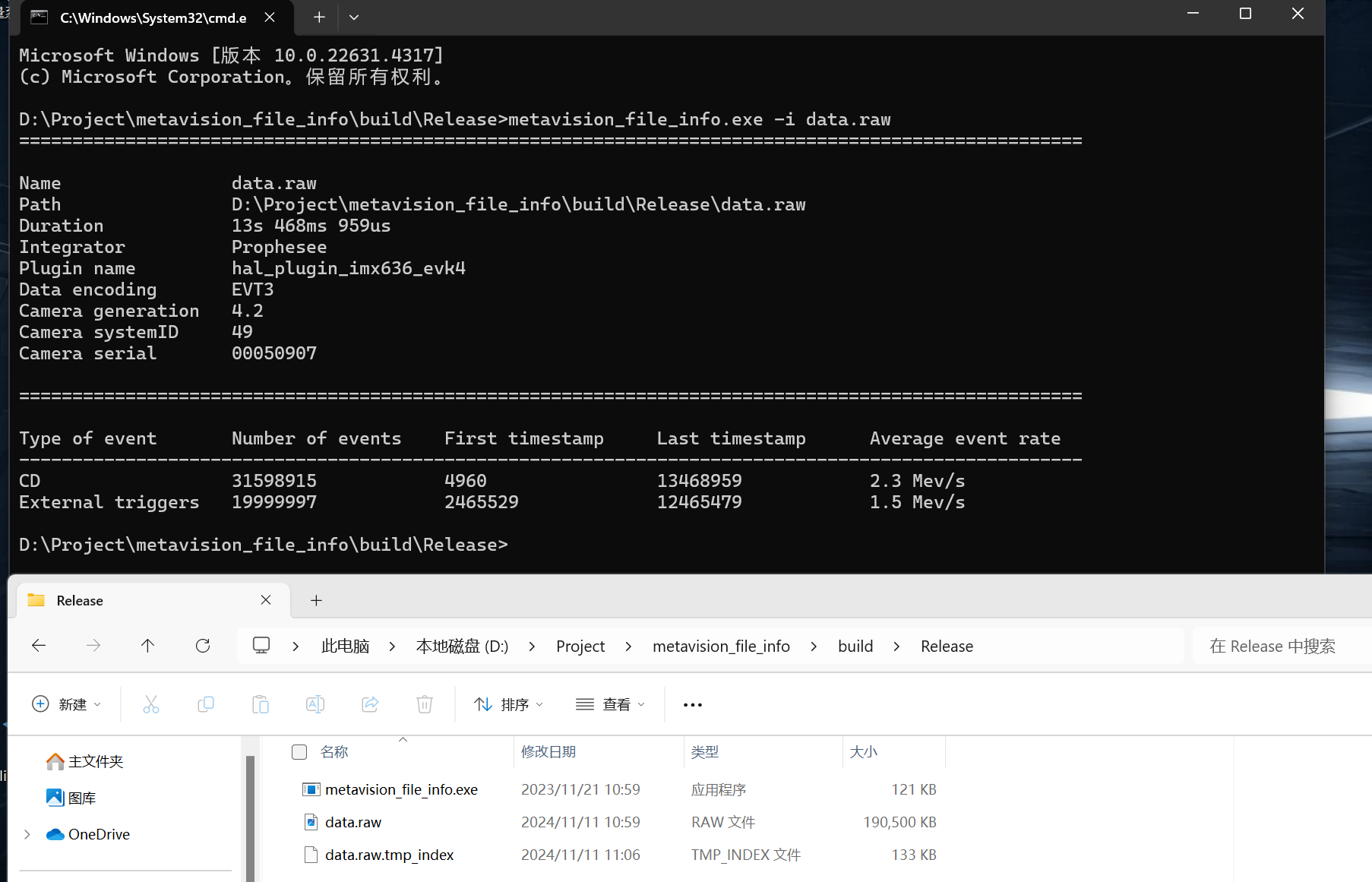

RAW file trigger information

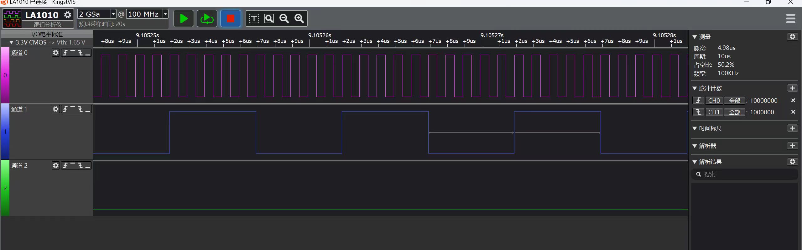

3、When opening RAW files through METAVISON software, the screen keeps getting stuck, and the effect is as shown in the attachment.
4.problem
4.1. Want to know how to solve this problem
4.2. Regarding the correspondence between the external timestamp and the camera’s internal timestamp.
