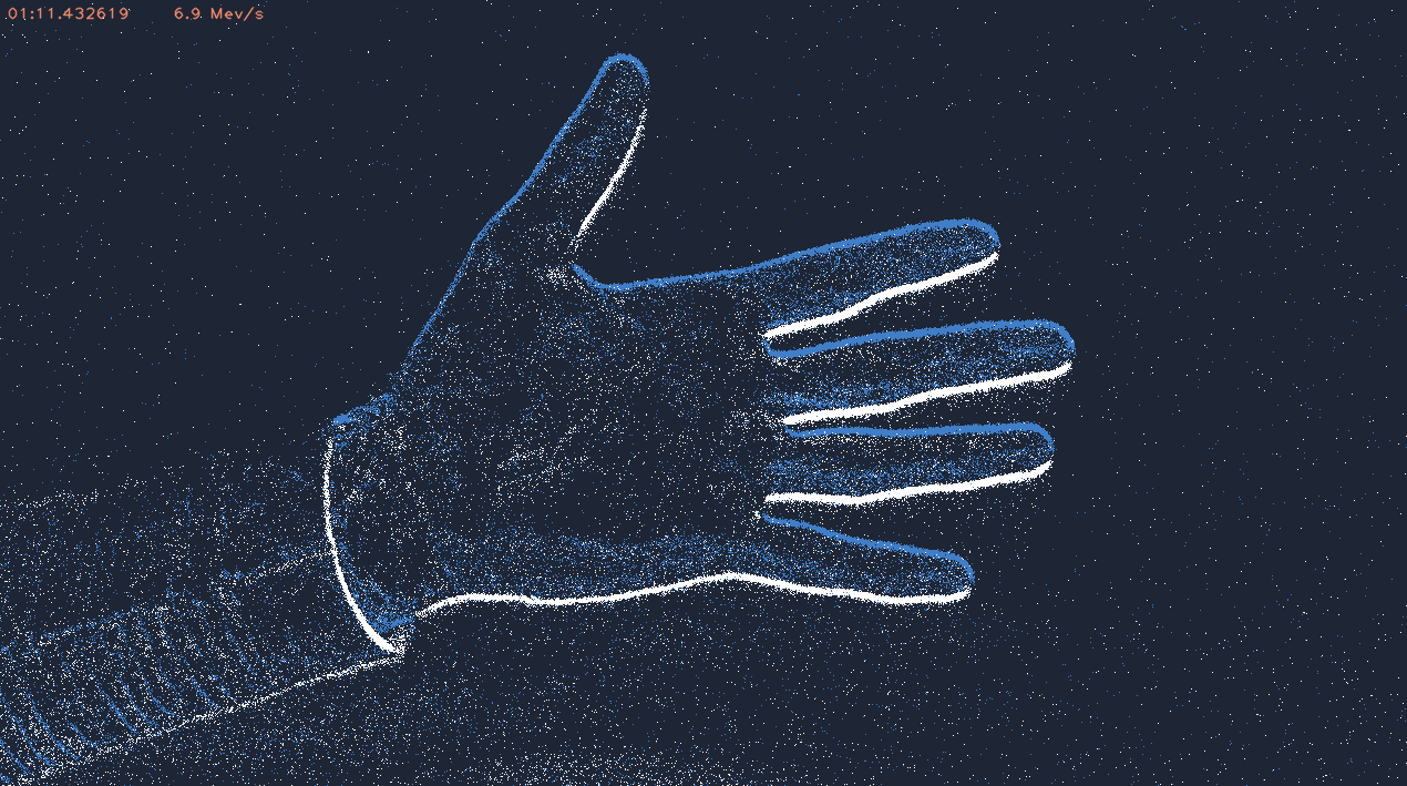

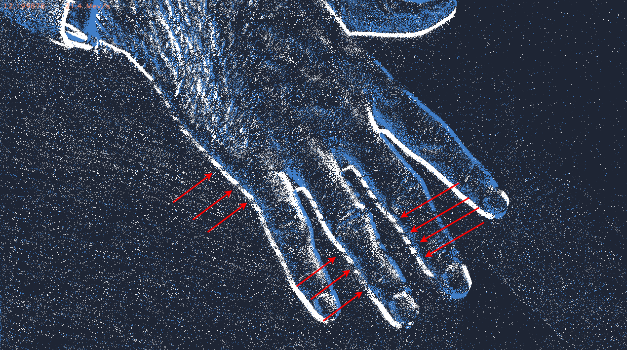

Also, the reflectance of the target object matters, as well as the background behind it. If the object has low reflectance, let’s say a black coin, it will be much more visible in front of a white background than a grey one. Textured backgrounds will also impact event generation (edges or textured objects will produce artefacts in the event stream). In the example below (see Background importance), the impact of a scene background (Prophesee offices with windows) is visible in the second image. Texture impact is highlighted on the sweater image, with a clear impact on the edges of the hand.

Figure 1. Flat white background
Figure 2. Textured background (sweater)

As you can see above, a simple texure or non-uniform background will impact event generation, and might degrade your algorithms performance. It is very important to be aware of this and control the background scene.
In conclusion, for optimum results use a uniform background that contrasts with the object whenever possible. For instance a black piece passing in front of a white background, supplemented with additional lighting to boost contrast detection.

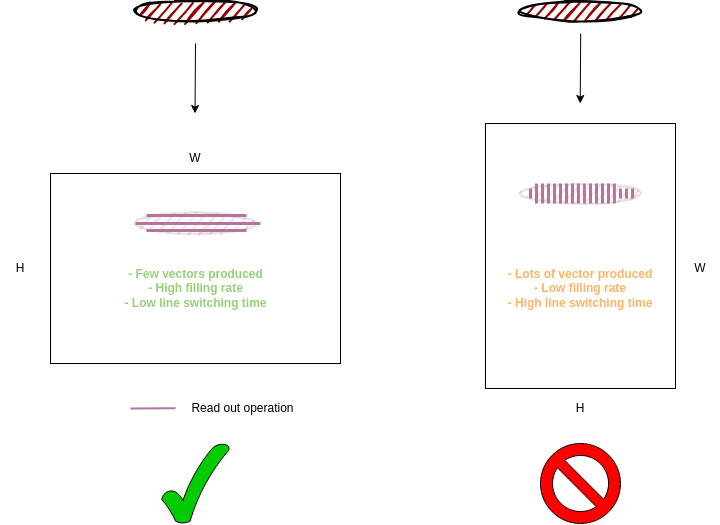

Even though Prophesee sensors allow pixelwise triggering, events are extracted line by line by the sensor readout process. The readout process produces vectors of events on the same line. If the edges are along this line, few vectors will be produced, and their filling rate will be high, but most importantly the readout line change is low. On the other hand, if the movement is along the columns of the sensor, then the readout will produce a lot of almost empty vectors, which might cause backpressure on the sensor to provide this quantity of vectors containing in fact very limited information, plus increased sensor consumption. On top of that, the readout line switch is quite time expensive in that case.
With the EVT3.0 event format, a compression operation is done to group event vectors on a same line in small data packets. This compression allows an efficient transfer from the sensor to the processing unit. In the case where few events occured on the same line (second part of the figure), the readout is highly used and might increase latency and data drop in worst cases (data buffer saturation).
In other words, sensor orientation is essential in case of main linear movements in the scene. In that case, the sensor should be placed so that edges are mostly along sensor rows.

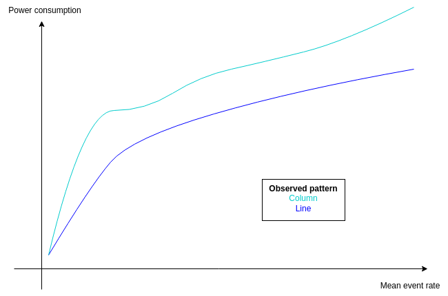

For instance, here is a figure illustrating the evolution of sensor consumption along with the event rate for various patterns displayed in front of the sensor. It is very readable that a line pattern (event lines falling down in front of the sensor) cause much lower power consumption than columns moving to the right (for instance). The increased power consumption comes from increased readout consumption for vector generation.
Figure 6. Sensor consumption for line and column patterns displayed in front of the sensor
Basically, the more events generated, the more efficient the vectorization, and therefore the more power efficient data transmission will be.
