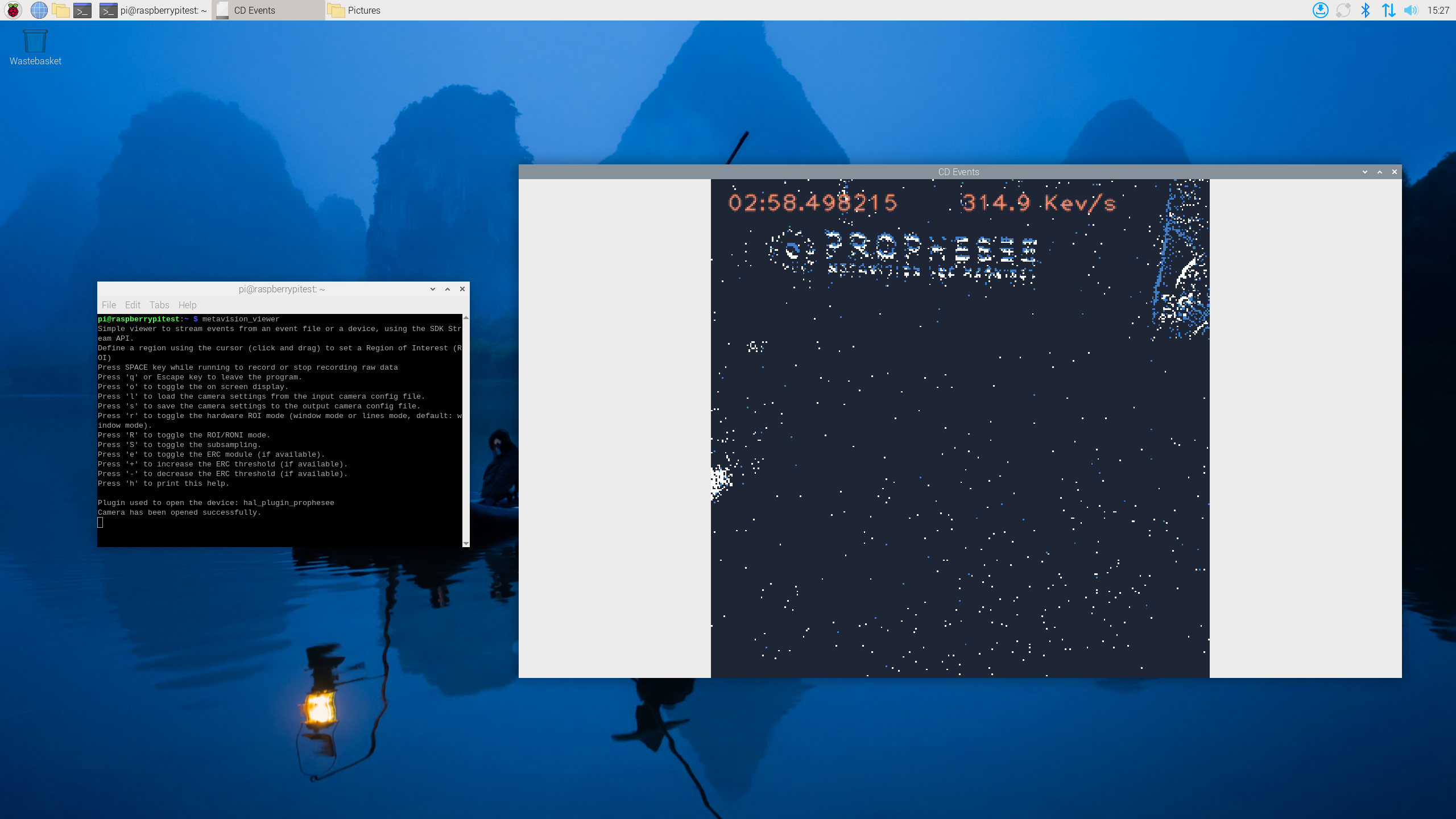

We recommend you to start with Metavision Viewer allowing data visualization, recording and replay:
  1. metavision_viewer
